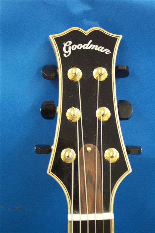

When I bind my head I couldn't bend the tight radius with the .090 curly maple I was using so I actually cut it out of solid wood-sounds crazy,but you can't tell inthe finished product-it looks like bent binding.
For the f holes I used thinner material and it bent fine.

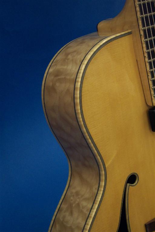

Alternately if you are looking for the multiline look as Brad shows in the photo above, you could laminate each of the lines one at a time onto the edge of the f-holes and then flush sand once all lines are in.

Brad, wow, very nice work!

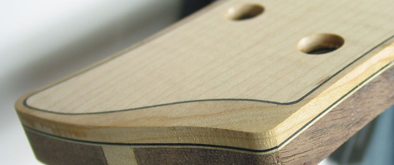

Nelson, maybe this will give you an idea of what it might look like out of solid material.
John Watkins

Way cool, John.
I assume the top purfling was done by the conventional method. Or was it CNC'd also?

Thanks, Nelson. The maple was cut separately with a .020" offset and then inlayed into the cherry. The black line is the adhesive; black epoxy.
